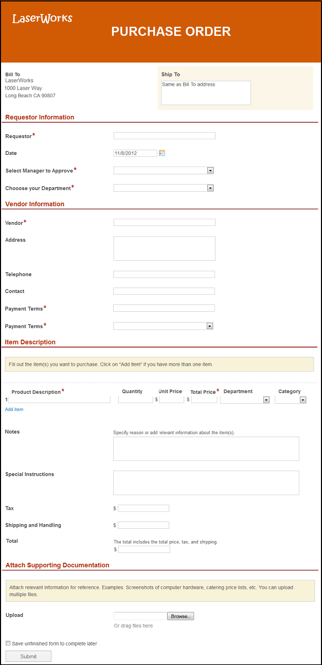

The events assistant accesses the PO form from the LaserWorks intranet. Here is what the full form looks like:
Purchase Orders New Process

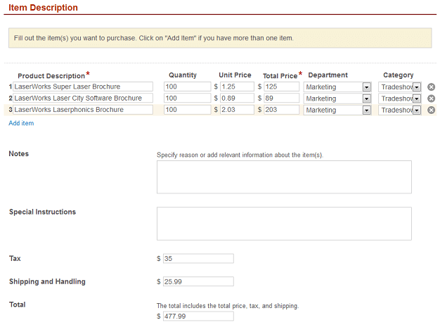

The events assistant fills out the PO with the required information. As she inserts quantities and unit prices of the brochures, the “Total Price” field is automatically filled out with the correct subtotal. When she adds in the sales tax and shipping/handling charges, the “Total” is automatically calculated.

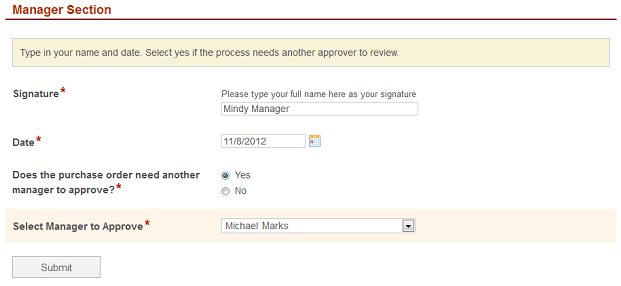

Once the form is completely filled out, the events assistant clicks “Submit” and the form is routed to the events manager for approval. The events manager must look over the form and sign it. She can also designate another manager to approve and sign the form. In this case, Mindy Manager has designated Michael Marks, marketing manager.
Events Manager Route

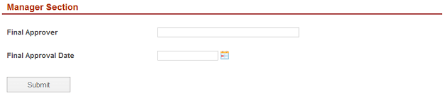

The form will be routed to Michael for his review. After this review step, the PO is sent to the accounting manager.
Manager Section

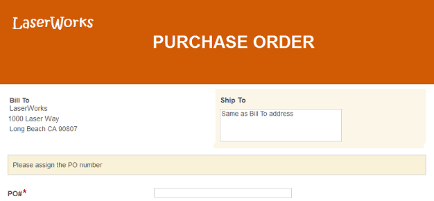

Once the accounting manager approves the PO, it is automatically sent to the accounting clerk who generates a PO Number and fills in the appropriate field on the form.

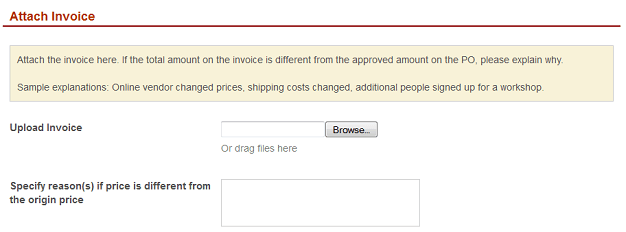

If the invoice has already been uploaded, the events assistant receives an e-mail with the PO number. If she has not yet uploaded the invoice, she automatically receives the form below.
Uploaded the Invoice
The form and attachments are then routed to the accounting manager for final review. Once the review is complete, the accounting clerk mails payment to the vendor and the form and its attachments are sent to a specific folder in the Laserfiche repository for final storage.

Information from the first form (the original PO form that the events assistant filled out) is copied to each of the other forms, with additional fields for each review step. For example, the form that the accounting manager sees is not the original PO form but the PO form with the special “Manager Section” appended to the bottom.

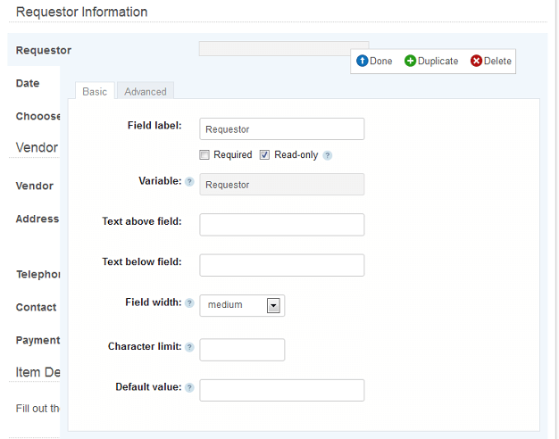

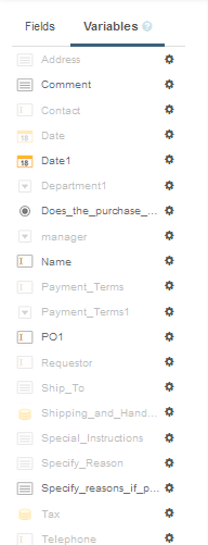

Each form field has a specific variable associated with it. This variable contains the information entered in the field. For example, the “Requestor” field has a corresponding variable called “Requestor.”
po8
When creating the form that the accounting manager sees, instead of inserting a regular field and calling it “Requestor,” we can simply insert the “Requestor” variable. This ensures that that the field will be populated with the same information entered in the original PO when the accounting manager views it.

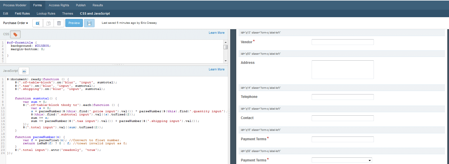

In order to get the form to automatically calculate the item subtotal (multiplying the quantity by the item price) and overall order total (adding the item subtotals with the tax and shipping amounts), include the following JavaScript in the “CSS and JavaScript” page:
po10_new
Click image to view larger in new window
This code relies on the presence of CSS classes on specific fields. Be sure to add the appropriate CSS class to your fields or the code won’t work. Exact code and instructions can be found in the Laserfiche Forms online help files.

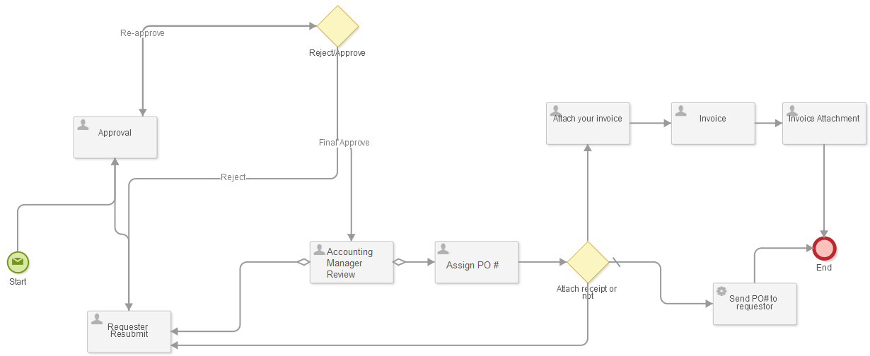

The business process is modeled in the Laserfiche Forms Process Modeler. Here is what the process model looks like:
Process Model
Actions performed by people, such as “Assign PO #,” are represented by user tasks; actions performed by automated tools, such as “Sent PO # to Requestor,” are represented by service tasks; and routing decisions are represented by gateways.
