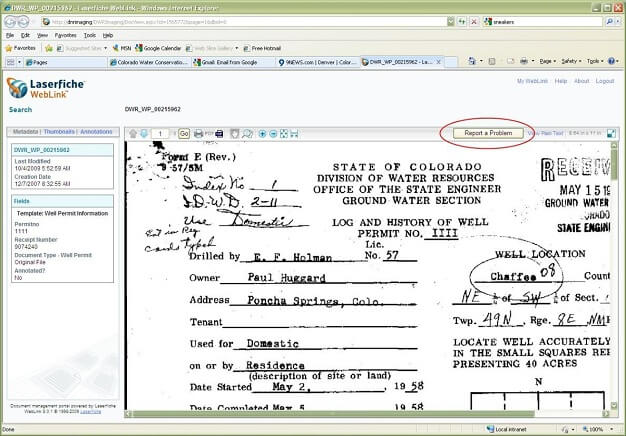

  • When staff members open a document in WebLink, they can see a Report a Problem button beside the regular WebLink buttons in the toolbar.

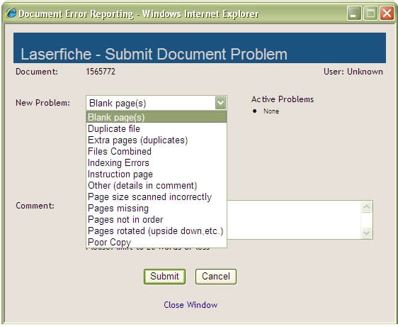

  • When staff members click on the button, the following form pops up:
  • This form allows staff to select a New Problem from a pull-down list and add a Comment (such as the number of the affected page) to help the Records staff quickly correct the issue later. Staff can submit multiple problems for the same document, one at a time, through this button.
