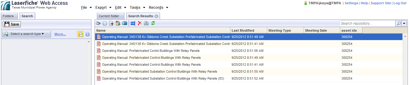

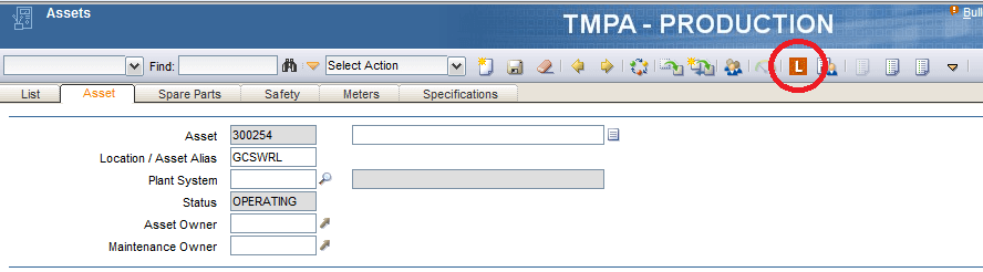

When an engineer logs into Maximo and looks at an individual asset, he finds a Laserfiche button on the toolbar.
Laserfiche Button
Clicking this button runs a search in Laserfiche Web Access for all related documents.
Laserfiche Web Access Search

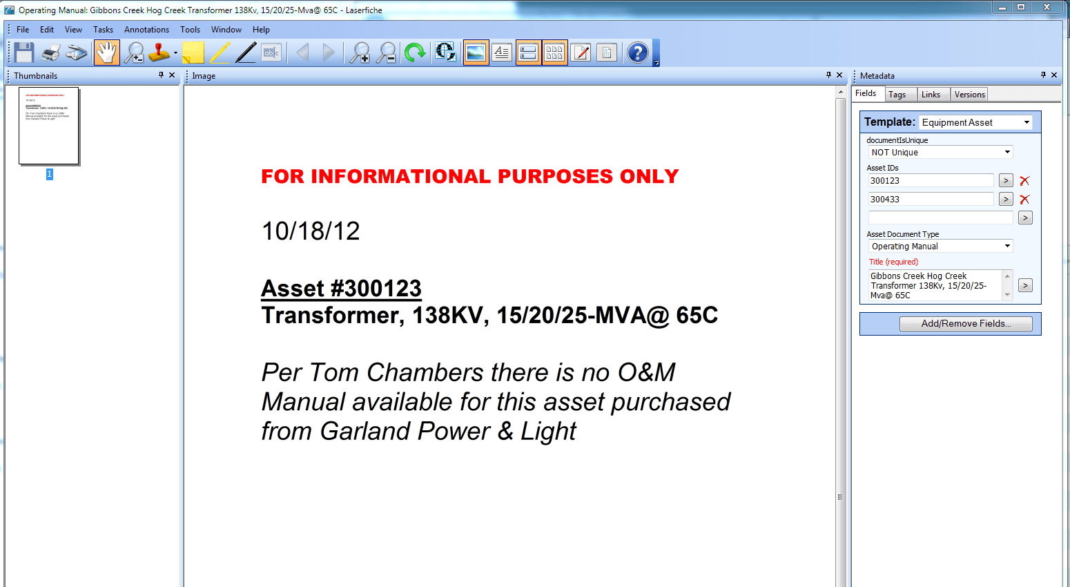

Each of these documents opens in the document viewer. For assets that don’t have manuals, we explicitly associate an informational page in order to improve the user experience and not return a page with zero results.

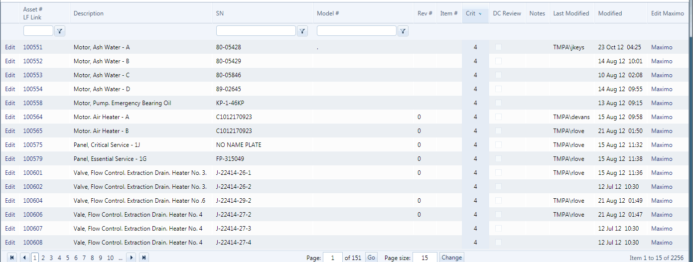

To facilitate this competition we designed a web application called the “Subject Matter Expert Review” or SME Review. This application lists all of the assets that still need documentation ranked in order of those most critical.
Sme Review
Click image to view larger in new window.
Each “Asset #” in the illustration listed above is a Laserfiche Web Access URL. Clicking on it performs a search in Laserfiche for all documents related to this asset. The Maximo link on the right takes the user to the asset application within Maxmio for edits or updates.
The web application additionally allows us to generate reports to present to management in order to show our progress and to credit those making the most progress. This competition has led to finishing this backfilling faster, as positive reinforcement encourages engineers to look for and enter the requested documents.

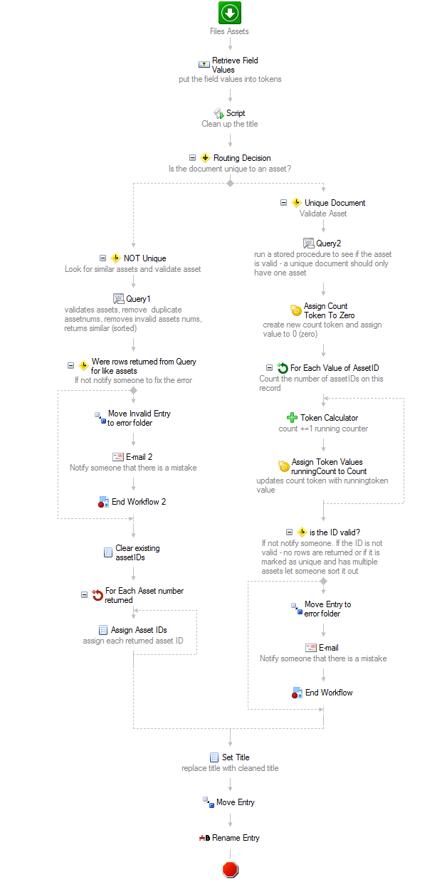

The Laserfiche-Maximo integration is powered by Laserfiche Workflow. As soon as documents are entered into Laserfiche, the following workflow is invoked:
Laserfiche Workflow
This workflow does the following:
  • Runs a custom VB script to clean up the title and file name by removing certain characters and applying title case.
  • Verifies that all assets listed as unique are actually unique by performing a query of the Maximo database to make sure that it only has one corresponding asset.
    • If the document is not unique or if the Asset ID is invalid, the appropriate person is notified by e-mail and the workflow terminates.
  • Executes a SQL-stored procedure for assets that are not unique that updates the metadata of all other similar entries.
    • If it turns out that the document is actually unique or the Asset ID is invalid, the appropriate person is notified by e-mail and the workflow terminates.
  • Moves the entry to its final storage location in “Maximo docsAssets” and renames it to the cleaned file name.
There is another scheduled workflow that runs periodically. This workflow processes all of the manuals in Laserfiche, queries Maximo to see if there have been any new assets added since the last update and matches them with existing manuals by updating their metadata.
